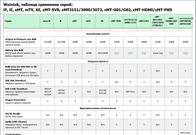

Weintek, таблица сравнения серий: iP, iE, eMT, mTV, XE, cMT, cMT X
Серия iP / iE eMT mTV XE cMT-SVR cMT3071
cMT3072
cMT3090
cMT3151
cMT3103
cMT-G01
cMT-G02
cMT-G03
cMT-G04
cMT-CTRL01
cMT-HDMI
cMT-FHD
cMT3092X
cMT3161X
cMT3102X
cMT3108XH
cMT3162X
cMT3152X
cMT3072X
cMT3072X2
cMT3072XH
cMT3072XH2
cMT3072XHT
cMT-FHDX-220
cMT-FHDX-820
cMT2078X
cMT2108X
cMT2158X
cMT2166X
cMT-SVRX-820
cMT-SVRX-822
