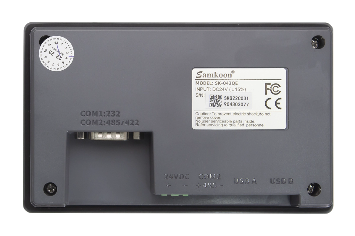

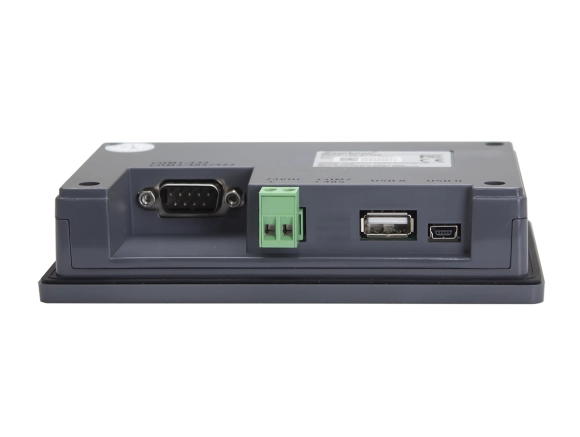

COM1 [RS232], COM2 [RS485/RS422]
#pin | COM1(RS232) | COM2(RS485) | COM2(RS422) |
1 | |||
2 | RX | - | |
3 | TX | ||
4 | |||
6 | RX- | ||
7 | RX+ | ||
8 | DATA-(B) | TX- | |
9 | DATA+(A) | TX+ |
